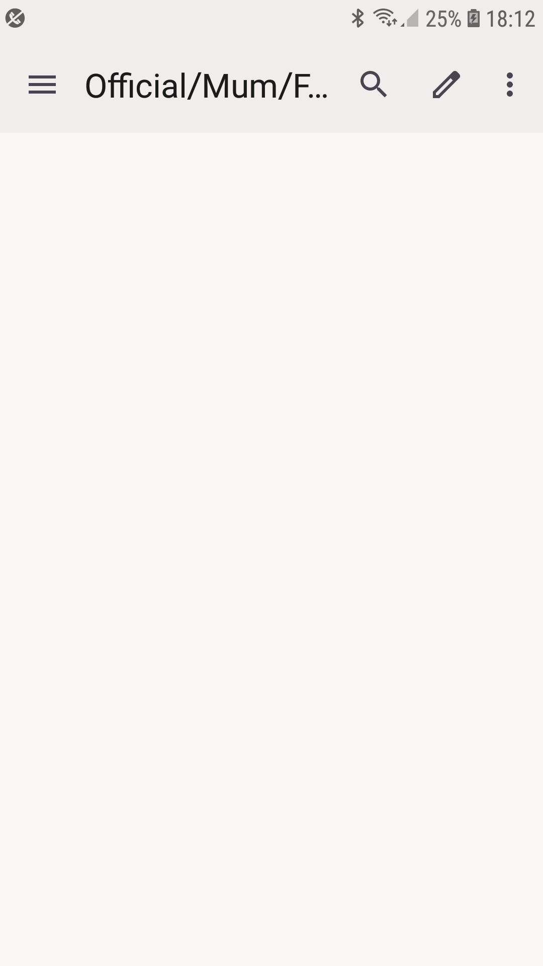

Contents of some IMAP folders innacessible in k-9 Mail
Starting today when I open some of my IMAP folders that contain emails, in K-9 Mail, I get a blank screen as shown the screen capture below. If I pull the screen down to refresh the folder it says “Loading messages” for about half a second and then goes blank again.
How can I fix this? or is K-9 Mail no longer a supported product?
I’ve tried refreshing the folder list but that makes no difference.
Dave
