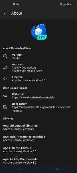

Google Play says I’m on the beta but I’m only up to version 17 after my last update a couple days ago. Do I need to do something else to get beta releases? Thanks.
What version is displayed by the app in settings > about?
17.0 is a standard release version. Beta’s are labelled such on the app’s icon and version number.
Search the play store for ‘Thunderbird Beta’. 18.0b2 is current.
I guess it must be that I’m still using K9 that I’m not getting the betas any more. I’ll install the Tbird beta and hope it imports my settings :slight_smile:
