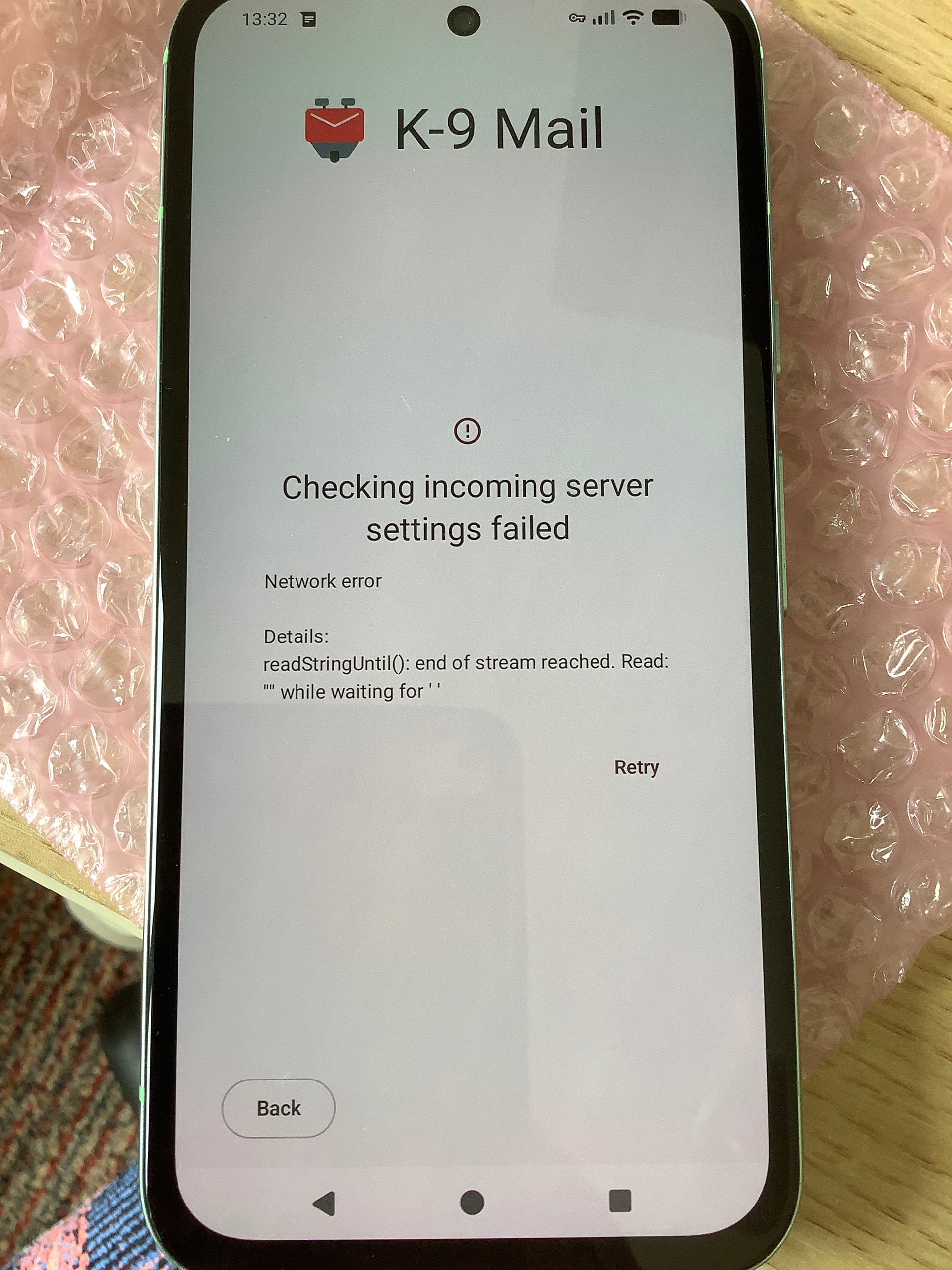

I’m totally new to K9 Mail, but I generally understand how to set up a email account within a client app. However, I’m struggling to set up a BT email account with K9. The app confirms that it finds my host and that all the details are correct, but when I add the password, I get the following error message. Does anyone have any idea what might be wrong? I have checked the internet connection is OK. I’m guessing it might not be an issue with K9 as I have tried another client app and that also failed, but with a different message.
Any help gratefully received.
Thanks!
Hi @BBaker
Welcome to the forum.
Are you able to try again later to rule out a temporary server issue?
If the issue continues, can you please log a new issue ticket on github.
Please capture a debug log and attach with the report. You can find a guide for this here. Developers will be limited in the help they can offer without this.
