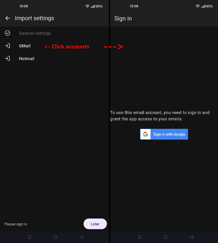

Regarding exporting settings, see my thread here, which no one replied to. When I last reinstalled K-9 Mail due to my phone being flashed, I had no luck importing my settings and had to follow the New Account prompts instead. I think this was because when importing the settings it asked for the server passwords - but as I’m using oAuth, these passwords aren’t valid. Is there any way of importing the settings so it uses oAuth and doesn’t ask for passwords?

Hi @Dave_Rado
While importing a backup of oAuth accounts, click each account’s name in the wizard to complete the sign-in process.
