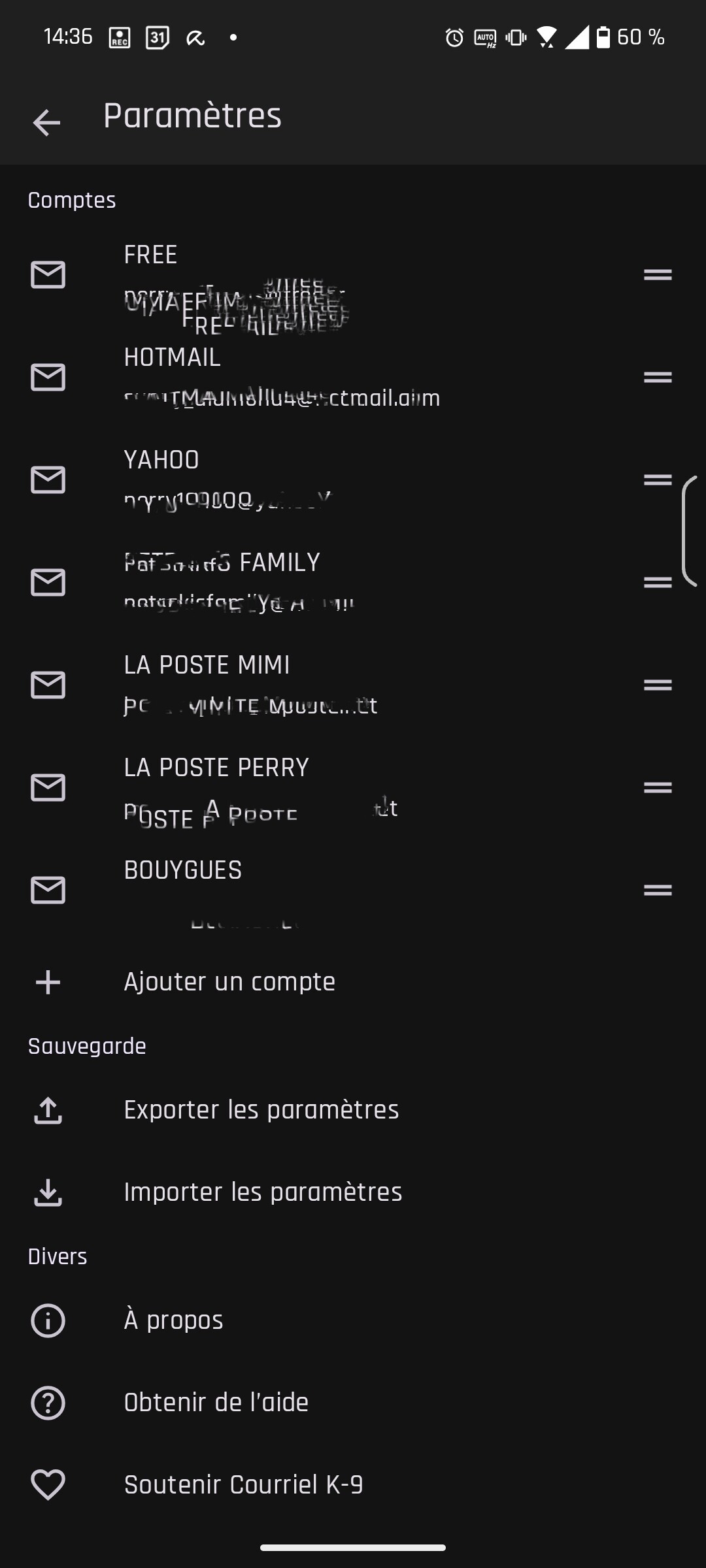

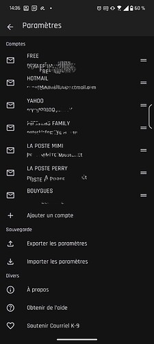

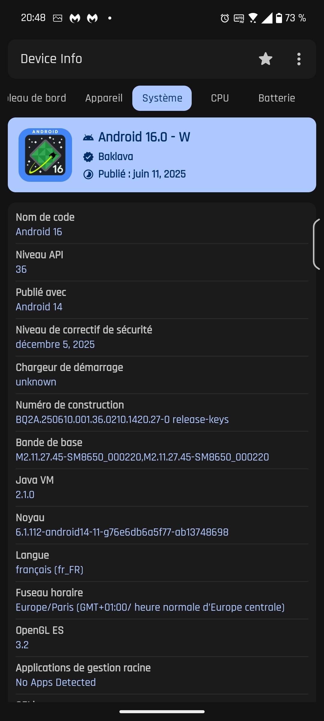

Here are some of the details
(attachments)
I recorded a short vid if I can send it somewhere
Zenfone 11 Ultra, everything worked perfectly until quite recently

Very little, I’ve been using Malwarebytes and K9 together for several years with no issue but I’ll try closing Malwarebytes. Everything started when l migrated from Android 15 to 16 but there could have been an update for K9 I am unaware of ?

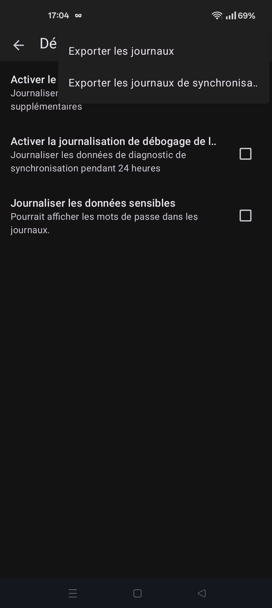

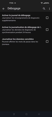

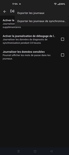

I’d recommend you enable debug logging and try and recreate the crash while it’s running. You should create a github issue ticket with the steps to reproduce and debug log. I believe you can also attach your recording.
Guide to collect debug log here

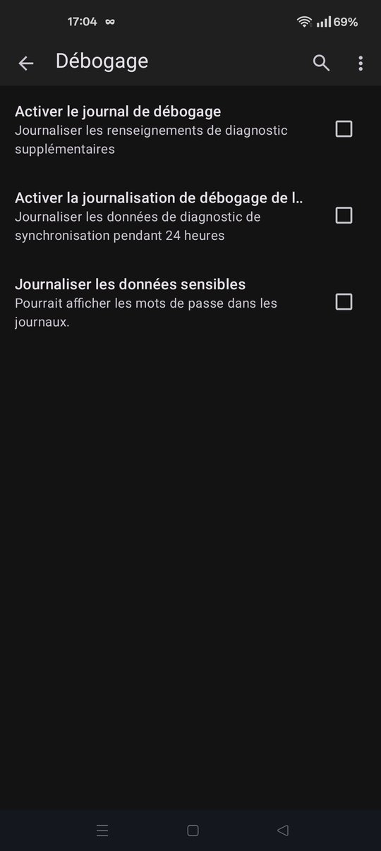

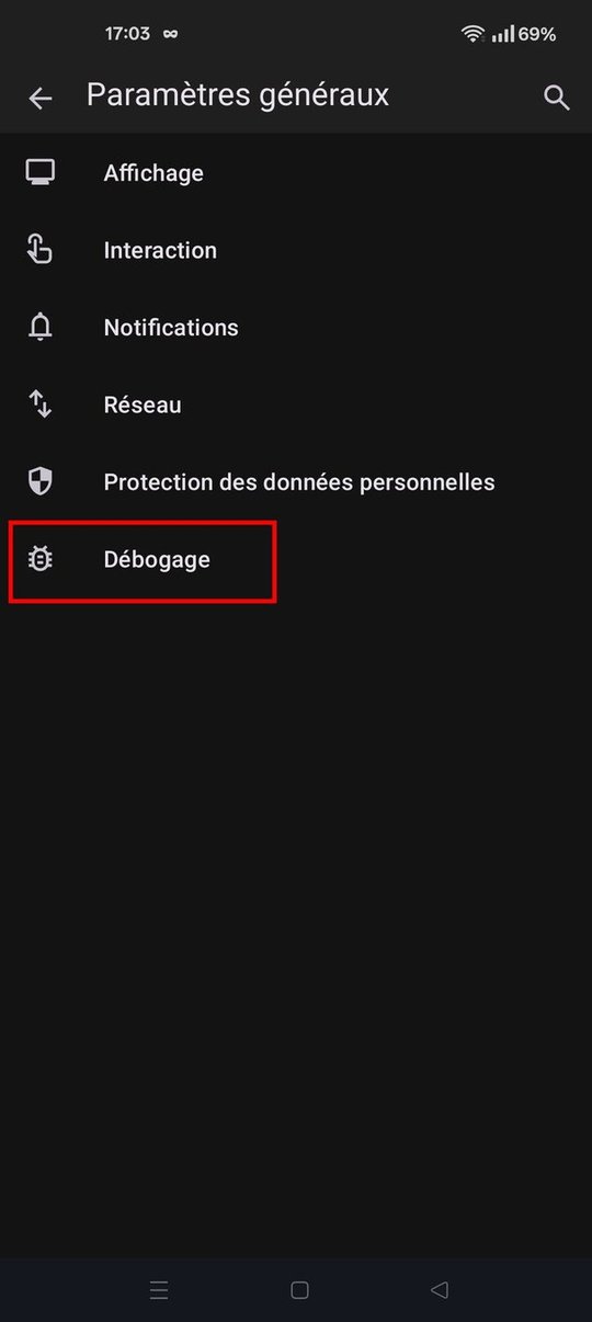

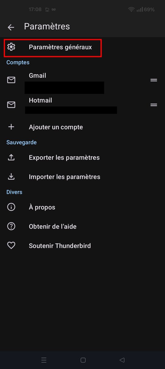

Not quite sure I have the debug command in the french version, I’ve searched everywhere if I click on “get help” just sends me to the forum? And I have noticed a new issue : when creating a new message, if you go back and fourth, the message is logically stored in the draft folder (ie. missing recipient). When you complete the message and send it from the draft folder, it will indeed be sent but a copy of the original message unredacted stays forever in the draft folder…
I’ve attached screen shots showing where the debug menu is, with language in French to help you locate it.
