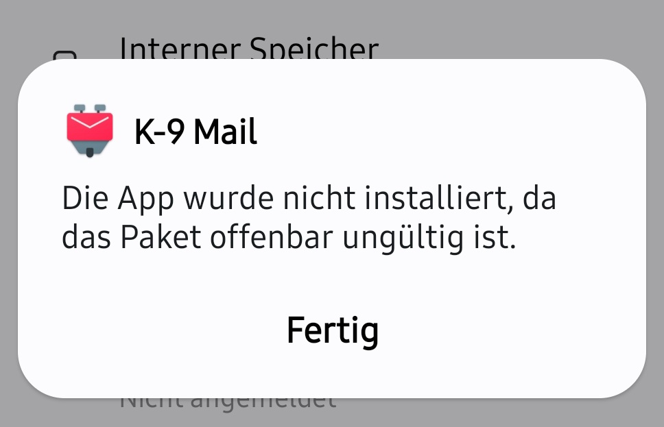

So I’ve been using the version “k9 mail 5.600 apk” on my Samsung Z Fold 4. Since today, I have the Z Fold 6 and when I want to download and install the APK file, I always get the message that the file is invalid.
Does anyone have an idea how I can install this version?

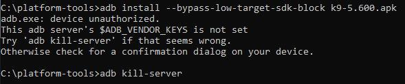

Download the Android device bridge to you computer and then run:
adb devices
adb install --bypass-low-target-sdk-block FILENAME.apk
adb kill-server
That will circumvent Android 14’s target restrictions.

Before you attempted the installation, did you connect to your device using a USB cable and ADB to allow the use of the outdated package?

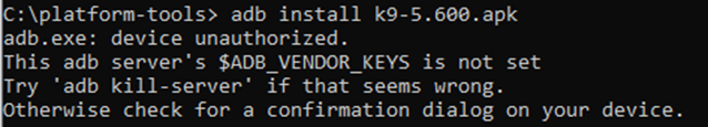

With a lot of effort and YOUTUBE video tutorials I have now installed it but apparently there is still an error somewhere.
USB debugging is “active” on the Samsung Z Fold 6.
ADB
What should I do?

The top result from Stack Overflow seems relevant.

Click the Brave Search link I shared. Follow the top search result from where a Stack Overflow post explains how to fix the ADB device unauthorized error you are seeing.
