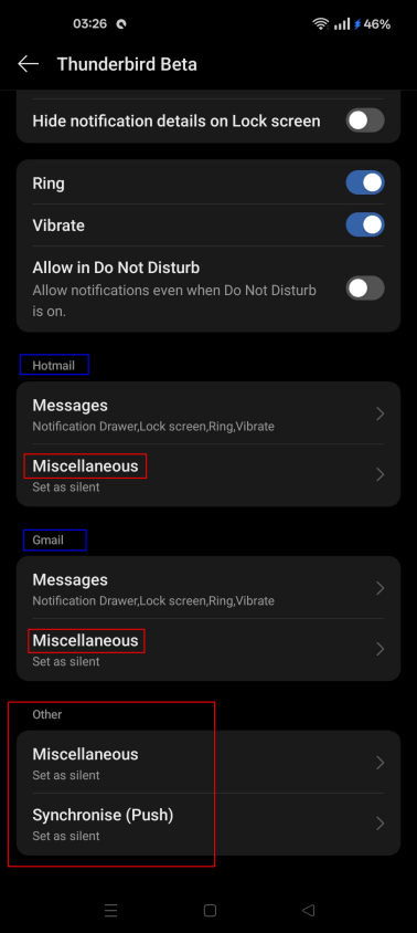

Hi @TPSchultz

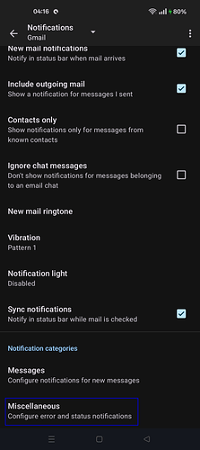

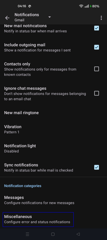

If you long press on the K-9 launcher icon, you should hopefully see an app info option to select. From there, click manage notifications.
Alternatively you can access some of these settings in the K9 app via.
Settings > Account > Notifications .. Notification Categories
You should see “Messages” and “Miscellaneous”
Android 16 also made changes to how notifications sounds are handled, and there’s reports of at least one bug so I’d check your Android settings as well.

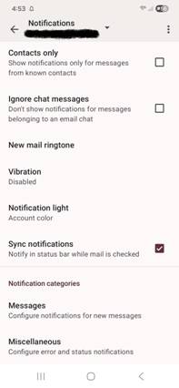

Thank you for your reply and screen shots.
My menus are somewhat different than yours, probably because I see you’re running a beta version, but I managed to find the Miscellaneous notifications menu you were describing. My version doesn’t have the Synchronize (Push) menu. That menu is used for setting the Errors and Status alerts, but mine is set to Silent, so that isn’t my problem. (I hope this screenshot comes through, as I am posting via an email reply from my desktop PC.)
