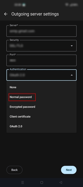

When you select normal password in K9, what error is displayed?
It should not be trying CRAM-MD5 if “normal password” is selected.
K9 uses AUTH LOGIN when AUTH PLAIN is not advertised by the server.

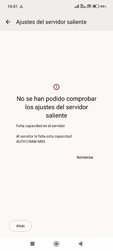

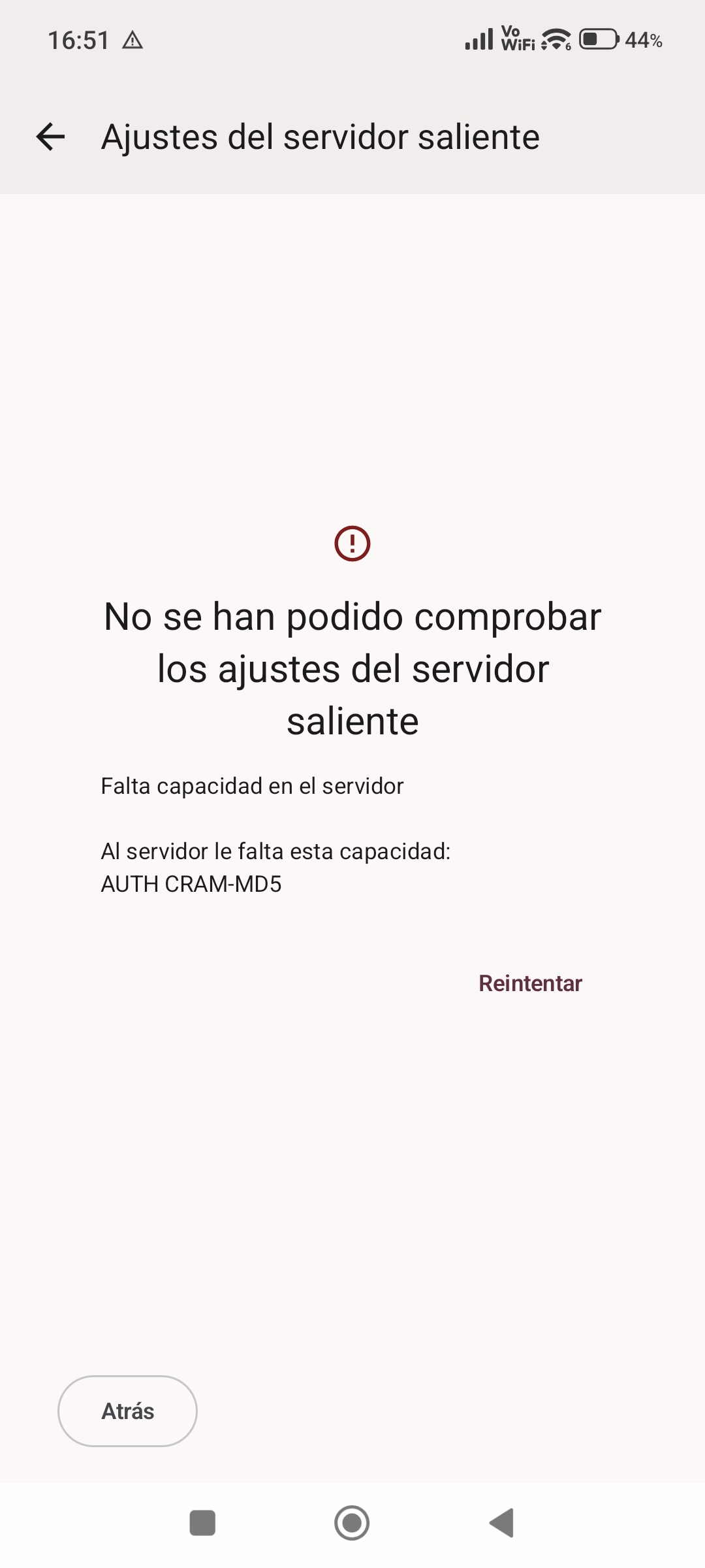

Yes, always same error CRAM-MD5 as screenshot
With StartTLS , SSL or without it.
I test all settings and show same error.
The code uses CRAM-MD5 only when “Encrypted password” is selected in the UI.

Without a K9 debug log, opportunities to help you trace why CRAM-MD5 errors are observed when “Normal password” is selected in the UI are limited.
You can try posting an bug/issue report on Github and see if the developers can offer insight.
Plain Text was disabled too, only allow base64
Dont worries, I enable encryption on server
